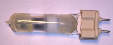

i myself wrote this a week ago , it may be dangerous but what do you think (noone replied to it ,so i post it here again):
Problem with retrofitting projectors is that there is not enough space. However i want to try to make a cdm-t or a similar lamp smaller.
1-i was thinking some projectors use 150w metal hallide lamps, My question is :will a different metal hallide work (electrical speaking , are all 150w mh lamps compatible or does a UHP (the lamps usually used in projectors) have a lower or a higher ignition voltage?)
2- if it would work then there is no problem using the original ballast and ignitor
3-you have to get a very small metal hallide lamp to fit in the original lamp house, would it be possible to remove the outer glass from for example a hqi 150 fc2 ?(its dangerous i know, you have to do it in controlled circumstances face protection , thick leather gloves )If you look at all these lamps
http://www.andrewjjstanley.btinternet.co.uk/metalhalidelamp.htm
you can clearly see the inner part which is seperate from the rest of the lamp, this is the part that lights up. The outer glass is probably uv protection. (and you can get that from the uv protecting glass of the original lamp house)
If you would remove the inner part (of course without breaking it) will it work? Has anyone ever tried this?
4-then there is the problem of fitting the lamp , if you have the original lamp house , you would have a reflector and all the things you need, just put your slaughtered hqi in there , and there you go 10000 hours for 30 bucks!
Am i completely stupid , or would it work?
BTW i am not responsible if you blow your eyes out or get a lot of nice glass tatoos in your face , or get a nice hairmodel after killing yourself with a electrical igniter with 50KV , in other words dont try this at home or without the right equipment

UHP and MH (HQI) lamps are very different, most UHP-projector lamps run on DC-voltage some on AC. MH-lamps always run on AC-voltage. Acoustic Resonance is an other problem MH-lamps have, they get unstable on higher frequency > 4kHz, if a UHP-lamp have this problem I don´t know so the UHP-ballast maybe use more than 4kHz AC if the UHP lamp run on AC-voltage. Most 150w MH lamps are compatible with eath others, but not with UHP.My question is :will a different metal hallide work (electrical speaking , are all 150w mh lamps compatible or does a UHP (the lamps usually used in projectors) have a lower or a higher ignition voltage?)

here the question to the answer will a lamp run without the outer glass casing. It does ,this is about a mercury high pressure lamp , but they are very similar.

mathias> UHP and MH lamps are not that different , they are both metal halide lamps, pressures and gap lenghts are different but they are essentially the same and so they will both work on direct current (DC) i think.

About using the built in UHP ballast to metal halide lamps:
Here is a good link to all about discharge lamps, I think I have posted it before: http://members.misty.com/don/dschlamp.html
As I have sad before most UHP-lamps run on DC-voltages and mh-lamps don´t. From the link above:
"Metal halide and sodium lamps should not get DC. Use these only with ballasts that give the bulb AC. In metal halide lamps, ions from the molten halide salts can leach into hot quartz in the presence of a DC electric field. This can cause strains in the quartz arc tube. At the ends of the arc tube, electrolysis may occur, releasing chemically reactive halide salt components that can damage the arc tube or the electrodes. The arc tube may crack as a result."
Mh and HQI have a ignition voltage 3000-4000kV, UHP have 5000kV.
Here is an other link how HID lamps works: http://www.ballastdesign.com/overview.html
So I think the best and safest is to try to disconnect the built in ballast, and use a external mh-ballast to the 150W mh lamp.
Thanks Mathias!!
I have found that my projector uses a DC lamp.
This more likely than not means that a MH lamp will NOT work with the original Ballast/PSU.
I will not try it since I think it will be a waste of a good lamp.
So I will be ordering a 150W ballast, an ignitor and a 150W HQI lamp instead for around £60 the lot. Unless someone knows where I can get it cheaper in the UK...
