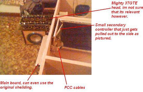

15" Viewsonic VE150
15" Viewsonic VE150
350:1 Contrast Ratio.
75hz Input Max.
30ms Response Time (Absolutaly no ghosting AT ALL, no matter how much action.)
1024x768 Native Resolution.
Very easy to strip, even has something like 40cm FCC cables that go from the main board and the LCD..
15" Viewsonic VE150
75hz Input Max.
