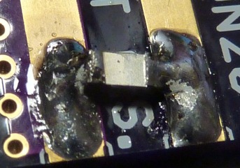

As i said, advising pps caps to smd beginners is a bad road. Mark, next time, try to solder it by hand, to a pad with ground plane reference.

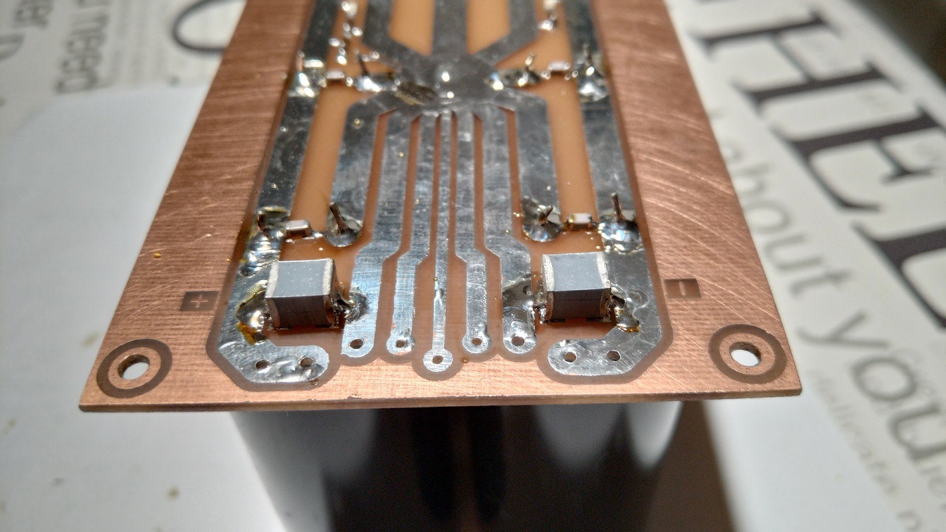

Well I can surmise is your soldering iron is not temperature controlled or burns butane, or you have counterfeit caps. I've resoldered that 12nF capacitor to a PCB making a real meal of it, using lots of solder, repeatedly and taking ages. Before it measured 12.14nF, after 12.15nF. Very stable still.
So I strongly advise PPS as a surface mount film capacitor, they work really well in all my experience, perfectly suitable for beginners (if a reasonable size(!)).

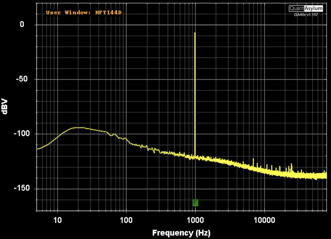

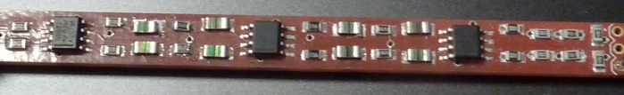

Polyphenylene sulfide is a very heat-stable material compared to most other dielectrics other than PTFE and some other exotics. Here's another board with lots of them that works fine too:
Eight 220nF PPS caps implement two 4-pole high-pass Sallen Key filters and exhibit a clean frequency response. Four on the back implement a phono-preamp input stage, again works nicely.

What i can sum from this is, wima makes bad pps caps and panasonic does it proper. Still, i don't think you would be passing proper with solid gnd plane connected cap. It sucks too much heat away, but it still affects cap directly. Those on the salen picture look extremely like acrylic rather than pps 😅
My parts are only sourced from mouser. I don't have time to deal with fakes.
This one SMDIC03100KA00MP00
Solder if possible with proper gnd plane reference.
Since rubycon acrylic goes around the same price for the same value, no real need to go this film cap. 400C, easy to solder by hand for beginners, and no real threat to overheat on gnd plane reference. Where wima gnd plane should be preheated with heat gun then soldered.

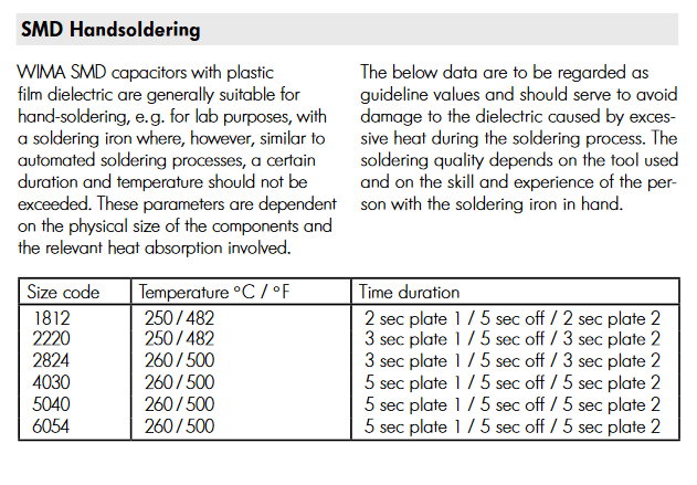

In the picture are KYOCERA AVX CB052E0105KBC (1uF/100V) very similar to WIMA. I solder them without any problems or damage. It is important that the tip temperature does not exceed 250C, the same applies to WIMA.

Don't get me wrong i use wima pps when i need higher voltage rating, but i use programable controlled hotplate, so all is well. And 2s <250C contact on a ground plane reference pad, i certainly won't call that a good solder point. We just have to agree to disagree on that point.
