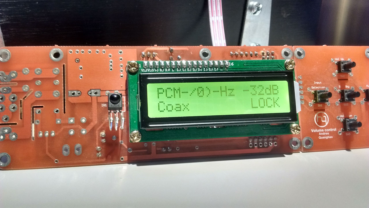

Well I finally assembled my version-1 DAC-END-R, with Lundahl transformer output boards.
Sadly, not working.
With original firmware, I tried coax input (CD player) and optical input (TV). In both cases the display remained on "DSD" and no audio output.
Then I flashed the firmware to ver 57a. Slight change - now the display remains on "PCM" but still no audio output. I tried coax input, optical input, and also I2S input from Beaglebone Black. With each input, When I toggle from menu-mode back to normal-mode, I see "PCM-/0)-Hz" displayed.
It seems the DAC does not recognise the incoming digital data?
Andrea suggested I use firmware 64a. I flashed this firmware. No change.
Andrea suggested I check the ribbon cable and its connections. I removed the controller, tested the ribbon cable with multi-meter, re-soldered 2x connections at the controller. No change.
Is there anything else I can check, please?
