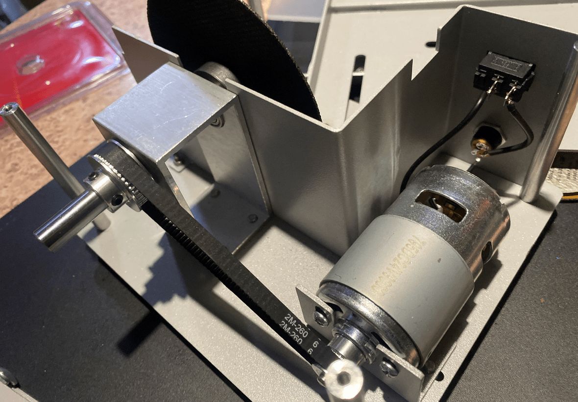

Another project put aside due to home renovations and new baby. Time to get this one going as it's holding up other projects. The blade attachment has built in arbours for circular saw blades and grinder blades to 110mm. I have got some aluminium and composite cutting discs to change to for my Silver Lady chassis project.
A sliding table-top will be tops for alloy work, so this will be the first mod

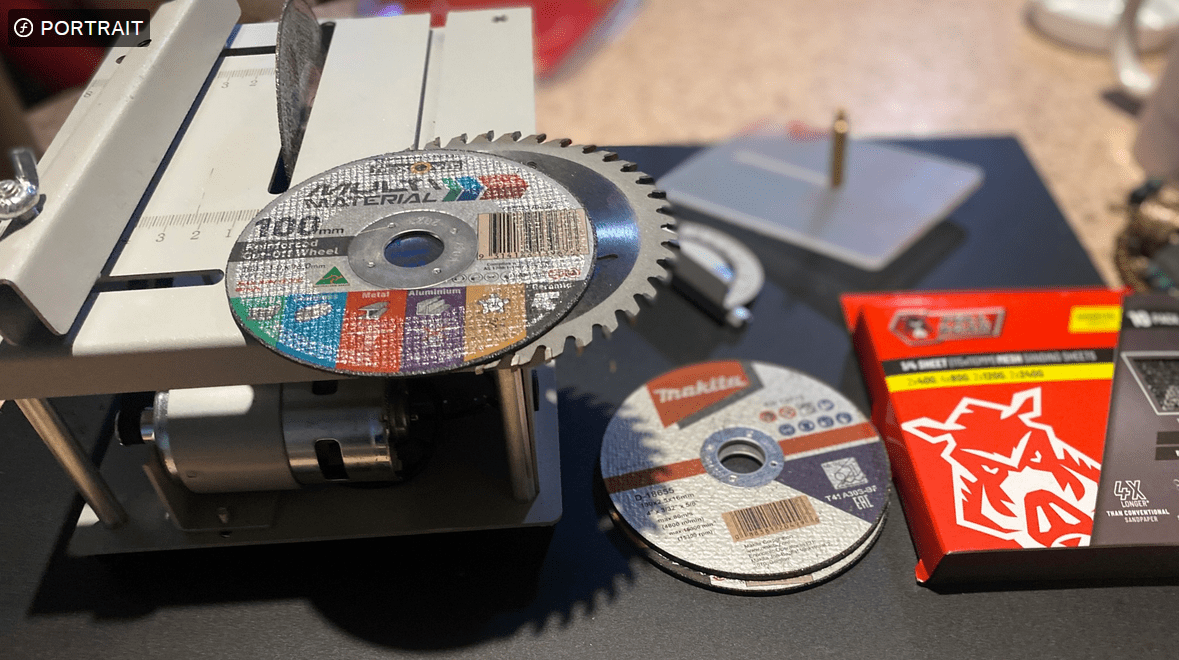

Lets start this off. Below is the link to the AliExpress item. This is available for cheaper in AU via a local stockist on Ebay. There are other machines in the same price bracket but this lil beauty is modular and can be taken apart and rebuilt to suit ones purpose
https://www.aliexpress.com/item/1005003204591361.html?spm=a2g0o.cart.0.0.188338dabbCcB8&mp=1
Another plus with a 4" blade system is the blade price. It is possible to build a good collection of various blade types for a decent price. As I mentioned previously, the machine supports both circular saw and grinder type blades
For the first mod
Turn this into a competent chassis and small speaker cab cutter, working to a new target of 300mm cut length over the stock 80mm
Add an aluminium cutting disc of the grinder type
Order a circular saw blade for aluminium
Add a grinding disc
Mod the grinding disc, add hook and loop to the back, doubles as a table sander
Add a removable mini router using Dremel bits
Add a gantry with a press down drill bit using a DIY system

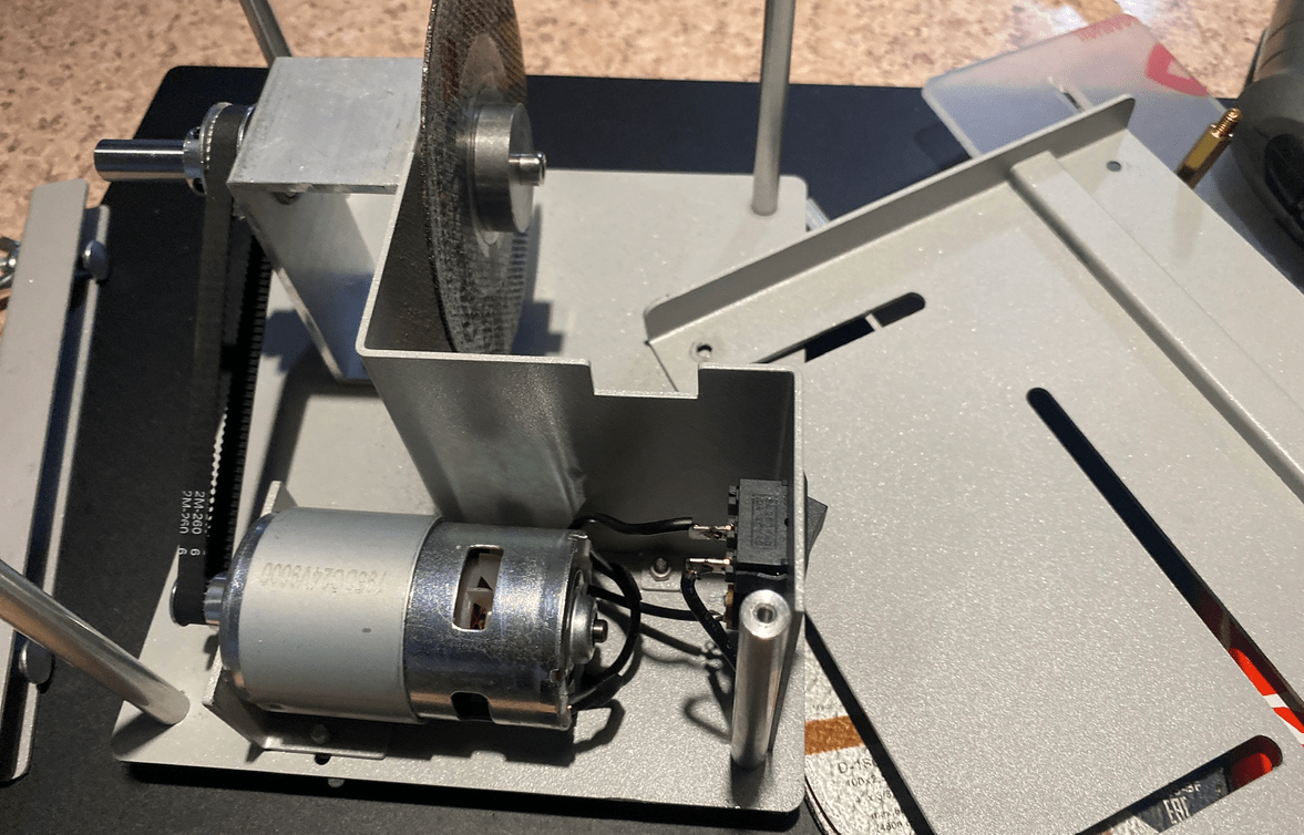

This is to be the quick prototyping machine to test out some ideas and one off builds and maybe the DIY community can chip in and help turn it into something serious
The following pics firstly show the blades. The cutting disc lists aluminium and the grinding wheel and the Full Boar hook and loop system for that mod. The next pic shows just how modular this machine is. All the parts are standard industrial and there is no fear of being locked into proprietary systems
I'll use thin MDF and some battens to set up a prototype for the targets. Just a simple sliding top and see if the table surface area can support that to do the cutting and cleaning for the Silver Lady chassis, inlays and trims as well as cutting blanks down to CNC work area for the Cub Sandwich heavy-duty mini sub project

First obstacle. I am short on flat sheet material. The largest have that can work is 300mm x 300mm 3mm MDF tiles which gives me a smaller work area but enough for the alloy amp chassis build. But I should be able to implement in a way to allow oversized cutting. If this setup works well, when budget allows, I will replicate in alloy plate. With a simple mod, the machine should be totally stable for sliders, too. Let me work on this and get back with some results
