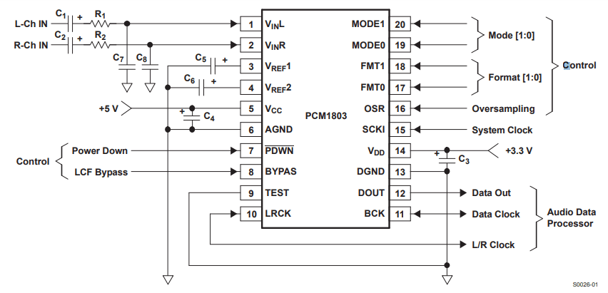

Yes, another (simpler) possibility could be PCM1803. I guess SCKI needs to be supplied from an external crystal oscillator.
