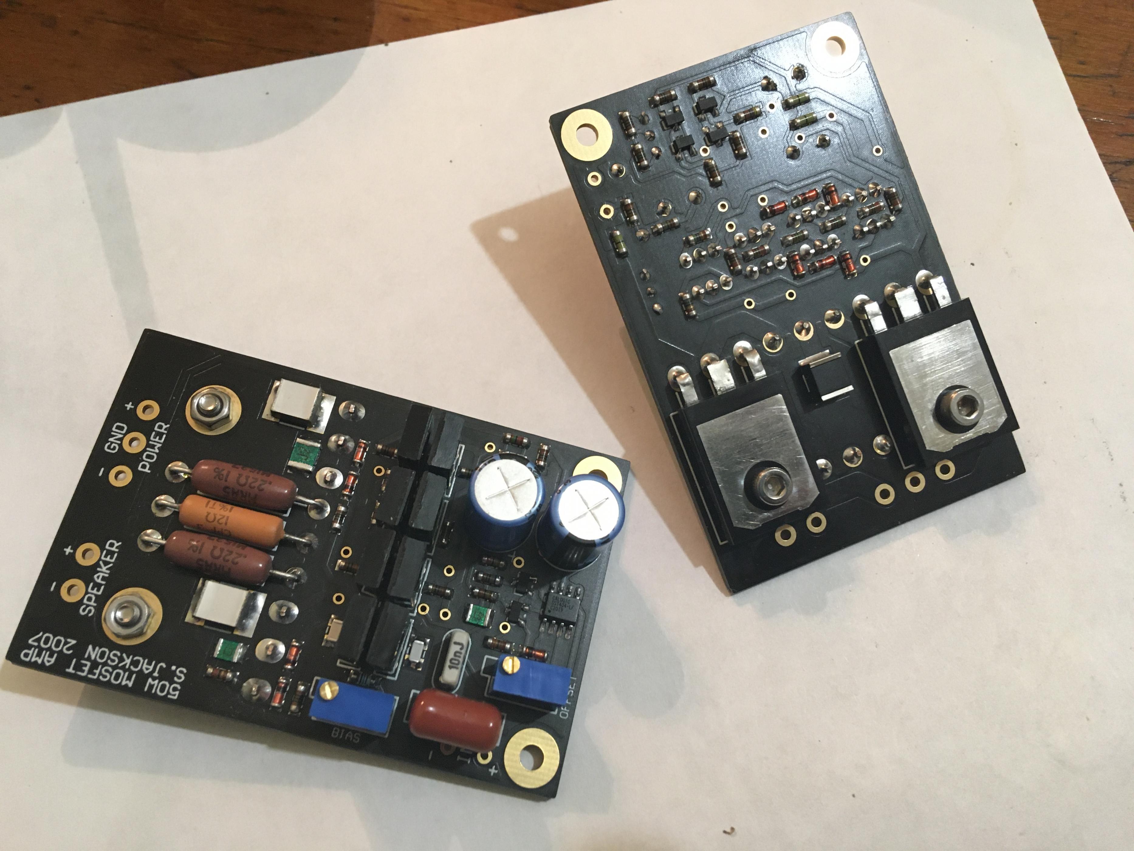

Nice weekend project. MELF's are the way forward
Nice & tidy work! Did you solder by hand or in a reflow oven ?
Thank you Jacques and Suzy. Done by hand very carefully, these are nice boards to build. I'm sure there is some therapeutic value to SMD work, especially with MELF packages.
Can't believe a 50W amp is the size of a credit card

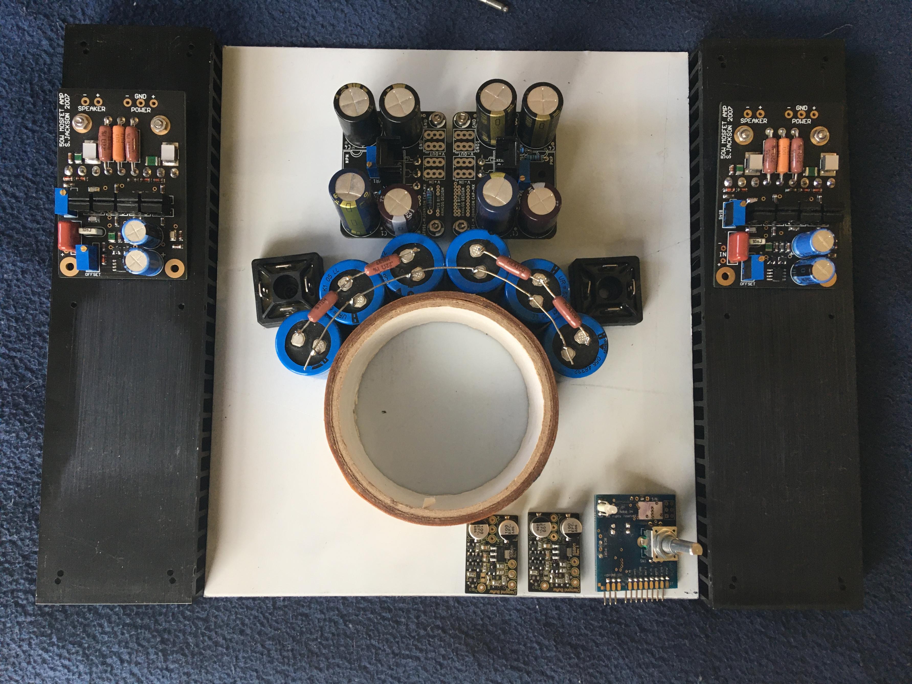

My proposed build will likely be an integrated with a muses volume and two Sjostrom diamond buffers which I have found to be a great combination.
Trying out a layout below with CRCRC around the toroid and Mark Johnsons Cap multiplier before the amps. Aiming for a compact build.

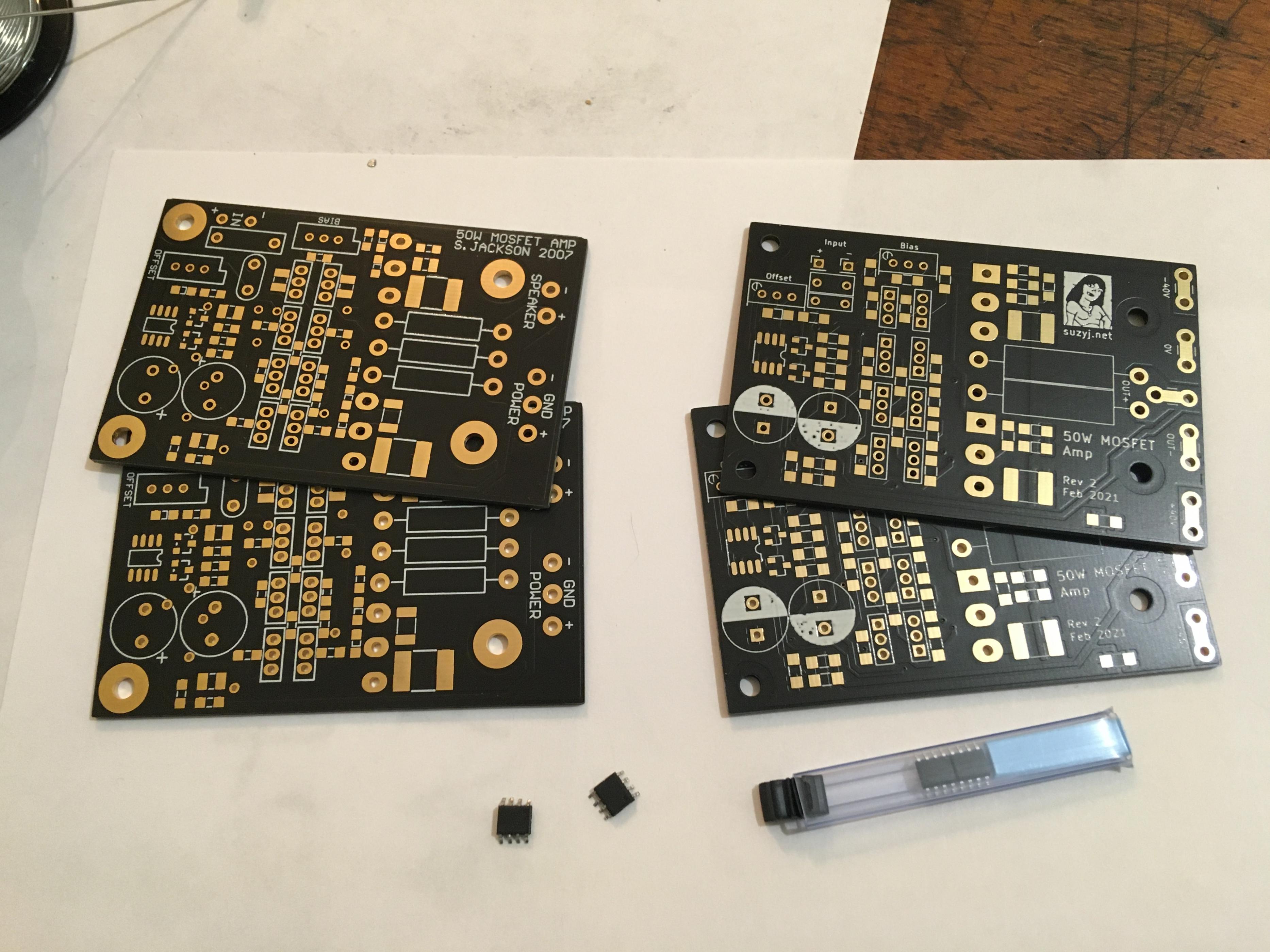

I really enjoy working with MELF parts. With the right tweezers they’re no harder than 1206, but they have lovely big solid end caps.
Have you tried the rev 2 PCB yet? I subtly revised the MELF footprint on that rev to space the pads slightly further apart, with a teensy bit more copper, so they’re really easy to hand solder.
Oh, and I’ll let you in on a secret. The rev 2 board should do 100W with dual-die parts, despite the silkscreen claiming otherwise.
