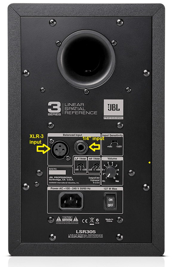

Hi all,
If I pull the trigger on the JBLs, I want to make sure I get all the other gear ready in time.
This is a DAC I was looking at (link here)
It has two RCA outputs on the back (one for Left speaker, one for Right speaker)
Do I just need to get these RCA cables (link here), and that's it?
It appears that there are 4 total metal things. I can't tell if it's one item (with two RCA things on each end), or if these are two separate cables. Is this the right item, or is there another item I would need for that DAC and the JBLs?
My PC has the ability to output via an optical cable. So I was just going to use that. I'm assuming that I still won't need to connect it via USB to power it, correct?

I was planning on:
PC --> optical cable --> DAC, and then connecting the DAC to the JBL 305P bookshelf speakers, somehow.
Will the RCA cables I listed above suffice? It seems like with that DAC, it's just one output for each speaker, and then the cable I've listed has 4 different pins (or whatever you call them). I vaguely remember reading something about positive and negative, but I'm not sure if that applies here.
User manual for LSR305 speakers
https://jblpro.com/en-US/site_elements/3-series-mkii-owner-s-manual-english
There is no RCA input jack.
What do you plan to use for a volume control?
